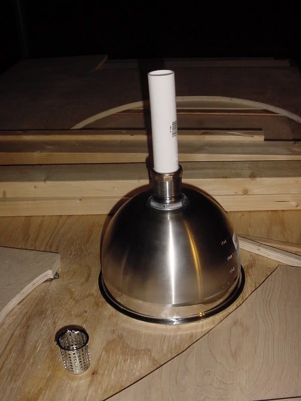

Ira wrote:Just put a lot of putty there, press hard, and scrape off excess.
Thanks Ira, :thumbsup: You Rock!!
Mk

Postby Miriam C. » Wed Feb 14, 2007 11:20 am
Morning Mary K,
Any chance one of the guys that cut the bottom can flange the hole for you? :thumbsup:
Postby Ira » Wed Feb 14, 2007 11:23 am

Postby Mary K » Wed Feb 14, 2007 12:10 pm
Miriam C. wrote:Morning Mary K,
Flange the Hole? Errrr, waszat?
Mk :scratchthinking:
Edit...Good Morning....

Postby Miriam C. » Wed Feb 14, 2007 12:19 pm
Sorry, Make an indent for the sink drain to sit in. They might have a tool to do it. :roll:
Postby Mary K » Wed Feb 14, 2007 12:24 pm
Miriam C. wrote:Sorry, Make an indent for the sink drain to sit in. They might have a tool to do it. :roll:
Ah, nope. They don't have those kinds of tools, we get a metal shop to do work like that. I will try it with the putty first, then work my way down the list...Thanks.

Postby Mary K » Wed Feb 14, 2007 12:33 pm
48Rob wrote:
Since most teardrops don't have holding tanks, there really isn't a need for a p trap, and any other potentially expensive plumbing parts.
I solved the same dilema on my mixing bowl sink by using a piece of vinyl tubing...also from lowes.
Heated it up just enough for it to slide over the tailpiece with a hair dryer, when it cooled, it was quite tight, no need for a clamp.
The flex tube allowed the drain to be routed further back in the corner, gaining me more storage space.
Rob
Hello Rob, Thanks for the great idea!!! :thumbsup:
So I can just find a hose to fit this...?
Mk

Postby madjack » Wed Feb 14, 2007 12:37 pm
MK, look for a hose...generally inna clear vinyl...with 1.5" inside diameter...they also make a flexible version of the tailpiece you have on the drain, which can be more easily routed...that is what Rob was referring to ....
madjack 8)

Postby Ira » Wed Feb 14, 2007 2:36 pm
I used the flexible piece that Jack is talking about (there are bellows in it that allow you to bend it as you want), but you DON'T find it in the PVC section of HD:
There's another section, near the sinks, where they sell these connectors. There's a plethora of stuff in that section, and it's all basically plastic--not PVC. So depending on your other connections/elbows/joints, you don't use PVC cement. There's another all purpose adhesive they sell in a little can that's good for both plastic and PVC.
