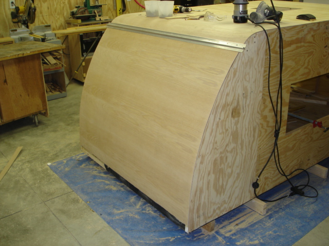

Postby Keith B » Thu Mar 01, 2007 8:46 pm
QUITTING MY JOB :o You know... that sounds more fun than you know.. however, I seem to spend more in a few days then I make in a few months on my "fun project"... :lol: , but I work to live, I don't live to work... The TD is coming together just wonderful... and I sooooooooooooooo believe the last 10% takes 90% of the time... as it seems to be going slower lately... The galley lid top is on (one layer of 1/8") and I dry fitted the hinge.... I think I turned out pretty good...Grant w/ Lil Bear Tag Alongs sold me the hinge.... so there's my "plug"... I thought it was worth the money.. fits good, works good, looks good, everything closes smooth, no binds, fits flush and even gaps on all sides...
More photos in my album.

Postby Miriam C. » Thu Mar 01, 2007 10:51 pm
:applause: :applause: :thumbsup: :beautiful: :woohoo:
Ha! I knew you could do it. Looks great!
Now GirRdun
Postby madjack » Thu Mar 01, 2007 10:58 pm
Keith...here is a reprint from a previous post of mine that seem to now be relevant at this point of your build....... 8)
To keep the hurricane hinge from sliding...1) cut the hinge so that it is 1"
longer overall than the width of the tear...this will act a deflector to keep
rain water from running into the galley 2) on the hatch portion of the hinge,
cut it off so that it is 1/2" shorter overall than the body portion 3) drill a
hole in the body portion of the hinge barrel 1/8th" from the ends and run a
small screw down into the hole after mounting is complete...this will keep
the hinge from sliding and from leaking.... ...also a piece of 1" x 3/16(or
1/4)" closed cell weather stripping, a couple of inches long put in-between
the closed faces of the hinge will help keep water out...we have done this
and have had no issues with the hinge...
...once again...cut the hinge AT LEAST 1" longer than than the body is
wide...this will give you 1/2" overhang on both sides to act as a rain
deflector...cut the hatch side a 1/2" shorter than the body side...this will
give you room to insert a screw into the body side barrel(both sides) to
keep the hatch hinge centered and prevent it from sliding side to side....
p.s we used insert edge molding and put an insert in it and the hinge...it
should be available from your local RV dealer or online from places like
RVsurplus...
Posts: 15128
Postby Keith B » Thu Mar 01, 2007 11:09 pm
Hey MadJack... thanks for the tips.. I was wondering about the sliding thing. I put a couple of "guides" inside the galley area to center it up as it gets shut but I like your idea much better. My hinge hangs over 1" on both sides (total of 2" longer than overall body) so I have plenty of room to do what you mentioned. I'm on the hunt for some weatherstrip. I've tried to get ahold of halfdome danny, but haven't seem to find him... he has some 3-4 ribbed strips that runs down the curved walls.. I really like that, almost like it's creating a couple of seals at once and any water that WOULD get in there would run down those channels and out. If anyone happens to seem him milling around I'd love to know where he got it. Thanks Madjack. Handles oughta be in later this or early next week to get it all latched down.
Keith
