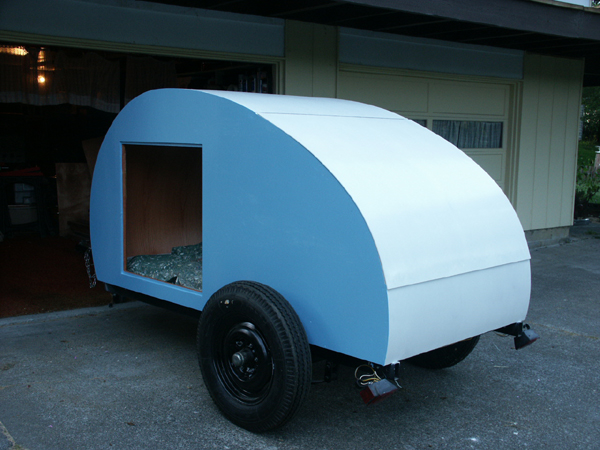

I used marine topside enamel on my trailer. I bought the paint, handed the cans to my Dad (retired house painter) and headed for my first teardrop gathering minus the trailer. When I returned home, my trailer looked like this. :lol: :lol:
It was painted with a brush.
