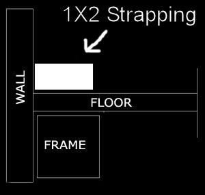

Postby Mikedaub » Fri Aug 21, 2009 2:34 pm
I'm glad I keep coming back to this forum because of all of the help.
Finally my summer is starting to calm down a bit and I am able to start back on building this guy. Rain all season in New England has me building everything in my basement, and piecing it together. Well, the rain has stopped, and its time.
When I thought about putting the walls on, I never thought about load weight of the build and after reading some of this post, I am concerned. Here is the way I was planning on doing it, Sorry for the bad photoshop skills.
So, I have the floor down, then was going to put the wall even with the bottom of the frame so it covered it and secured them together with the 1x2 strapping that is glued and screwed. For extra measures, I was also going to bolt the walls to the frame in about 3-4 different spots. Hopefully that makes sense.
With the strapping and bolts, think that will be strong enough?? For the most part, I used 15/32 pine ply and 1x2 pine straps.
Thanks in advance..

Postby kennyrayandersen » Fri Aug 21, 2009 8:26 pm
Mikedaub wrote:I'm glad I keep coming back to this forum because of all of the help.
Thanks in advance..
Why don't you just biscuit or dowel the floor (biscuits would be blind) to the sides and forget the strip. You could put biscuits or dowels every foot or so, and it would be very strong. Additionally, if you put bolts from side to frame, as you said you were going to do, it removes any loads that would want to separate the wall from the floor in the side-to-side direction. You could liquid shim the floor to the trailer with liquid nails or something (just to make sure the load from the flour goes into the frame). That way, you wouldn't have the strapping protruding into the cabin. :thinking:
kennyrayandersen
