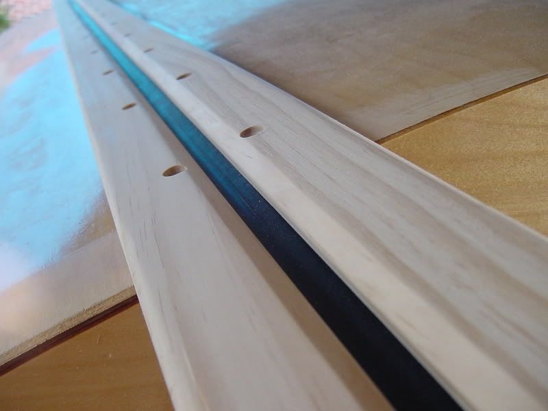

Postby Mary K » Sun Jul 01, 2007 9:40 pm
Well, I have the trim ready to install. Just need to glue and screw it :D
It is overhanging a lot, but will be cut back so don't panic. ;)
It only took me 4 1x2's to get 2 pieces of trim for the hatch. :oops: But I had to practice with the new table saw.
QUESTIONS:::::
Q#1: To be specific, I can use the PL Urethane Adhesive to install the hinge and trim right? I have not found the black stuff, but I do have 2 tubes of PL. This is okay right? It will seal it up but be flexible?
Q#2: ....... :scratchthinking: humm....DAMN, I can not remember... :oops:
Guess it can wait till later.... :oops: :oops:
Thanks, Mk

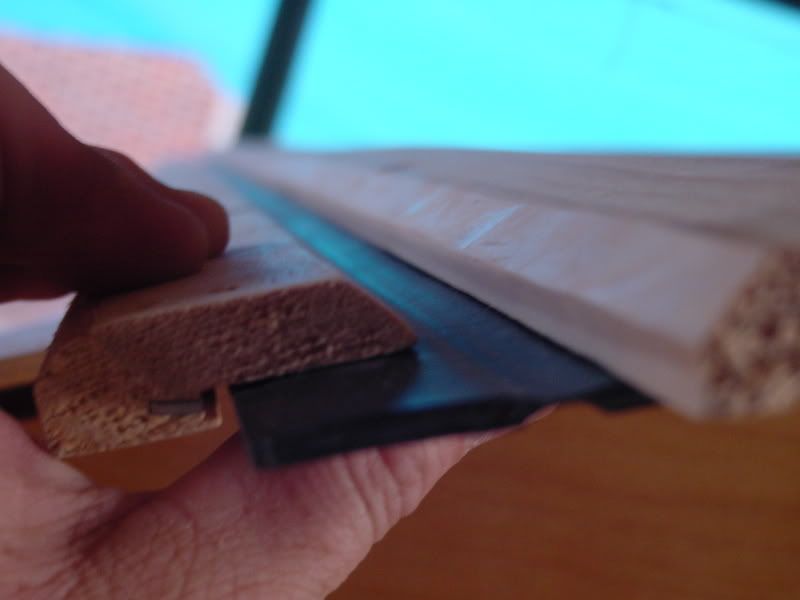

Postby Micro469 » Sun Jul 01, 2007 11:19 pm
Mary... I like your wood detail. How thick is that...1/2"? I know you saw mine... it's 3/4" thick, almost looks too bulky. I might take it off and put al or steel down, so it doesn't stick up so high. Let me know how yours works out.....

Postby madjack » Sun Jul 01, 2007 11:24 pm
MK, leave the hinge a 1/2" overhang on each side and make a small diveter(outta wood) to go underneath it(on the sides) to help channel water away while driving.....

Postby Mary K » Sun Jul 01, 2007 11:36 pm
Micro469 wrote:Mary... I like your wood detail. How thick is that...1/2"? I know you saw mine... it's 3/4" thick, almost looks too bulky. I might take it off and put al or steel down, so it doesn't stick up so high. Let me know how yours works out.....
:thumbsup: :thumbsup:
Well, it was 3/4" thick. But I thought it was too thick. So, with my branny new Table Saw I split it to 1/2" and then routered the outside edges with a roundy bit thingy ... took me 30 min to get the bit height adjusted. :? :fb
After taking some 150 grit and then some 220 grit and sanding it by hand, it smothed out the 45* angle cut on the inside edge. My elebow is killing me now. :o
Mk

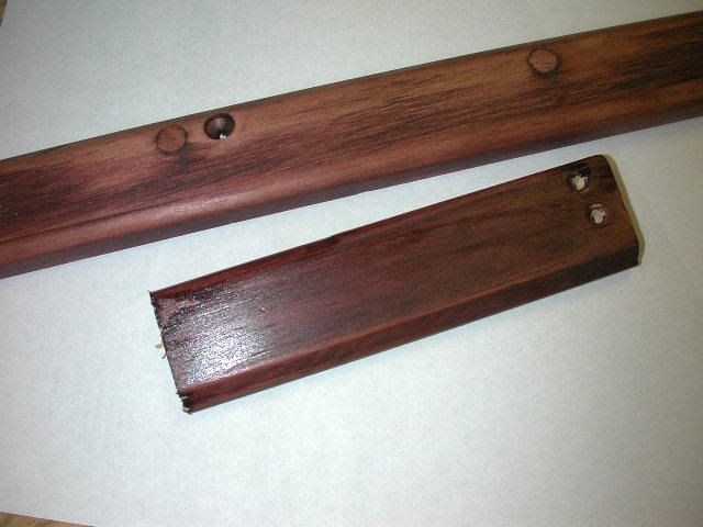

Postby Mary K » Tue Jul 03, 2007 2:28 pm
Testing out some trim stain on practice pieces.
The top piece is not a well sanded and I wiped on the stain with a rag. It sure does have an antique / distressed look about it. :thinking:
I was thinking of added the plugs after stain and having them as a decorative thing...but I just think I will plug it all and stain it.
Bottom piece is cut off from the actual installed trim so it is somewhat sanded and stain applied thick with a brush and wiped down after a few min.
Just thought Id post... :D
