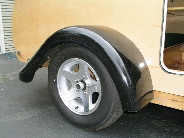

To answer your questions, Yes, you can build a 5x8, but I would look into splicing 1 or 2 feet onto it... You could even buy a 5x10 piece of plywood and build a nice 10' long trailer, like my Baja Benroy...
I did 5x5 baltic birch on my EH. I filled the joint with epoxy putty from the rot doctor, sanded it smooth, and painted over it... You can see the joint in this pic...
and here is the end result...
