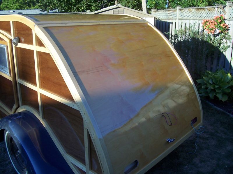

madjack wrote:Don, I could be wrong(probably am) but I don't think you can use microballons(or any other filler) in your epoxy, if you want a clear finish such as John has on his Woody....everytime I have used them, they added color and opacity to the mix
No, you're correct, Jack - If color is important, about the only thing he can do is what he's doing . . . . add another coat, sand smooth and add another coat - Until he gets the desired flatness. Even then, the ticker places meay have more color than the thinner ones
Lots of trouble . . . . but well worth it when you see the final product

Micro469 wrote:I went out today and bought a set of cabinet scrapers. I burnished one of them and tried it on a section of the tear. It went really well, and removed most of the orange peel effect in about five minutes. This will cut down my sanding time enormously. I still have to sand....Dangit, but it won't take as much time as I previously thought.... I think I can fix it......
Good plan! :thumbsup:
I love my cabinet scrapers too... Plus, this little handled blade scraper for getting into tight corners. A very good quality tool.
I got it from Hartville Tool, one of my favorite suppliers: http://www.hartvilletool.com/product/11211
I hope it goes well for you.

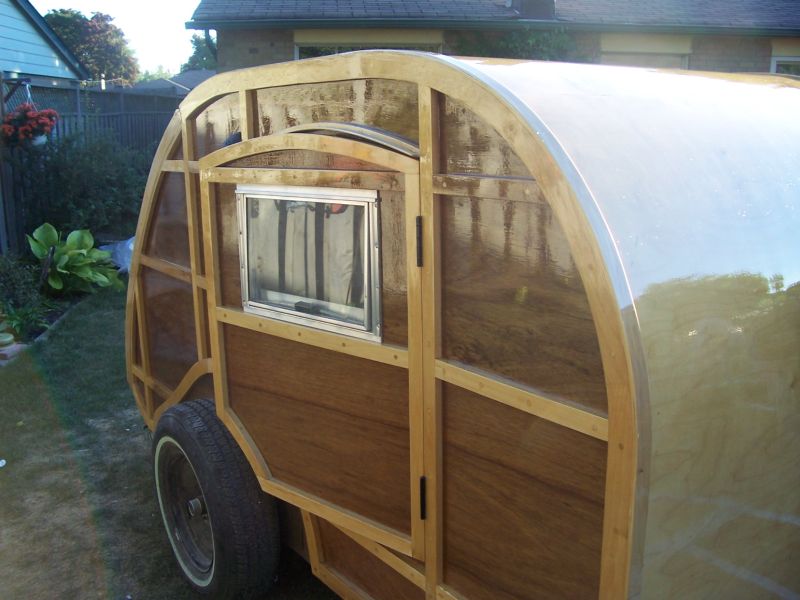

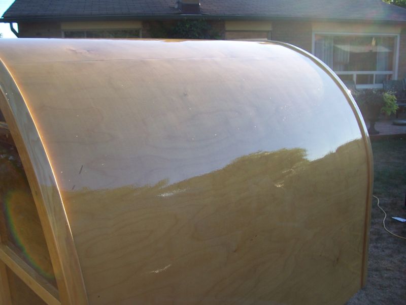

Postby Micro469 » Sat Sep 01, 2007 8:54 pm
After spending eight hours sanding the Tear, I recoated it with the fourth coat of epoxy. Took me all day, but am pleased with the result. Tho not perfect, I'm satisfied...

Postby Juneaudave » Sat Sep 01, 2007 9:12 pm
Sweeeeet!!! I've never seen such smooth epoxy. What'cha going to coat it with??? Inquiring minds NEED to know!!!
