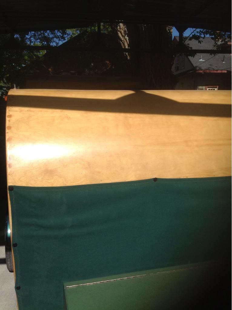

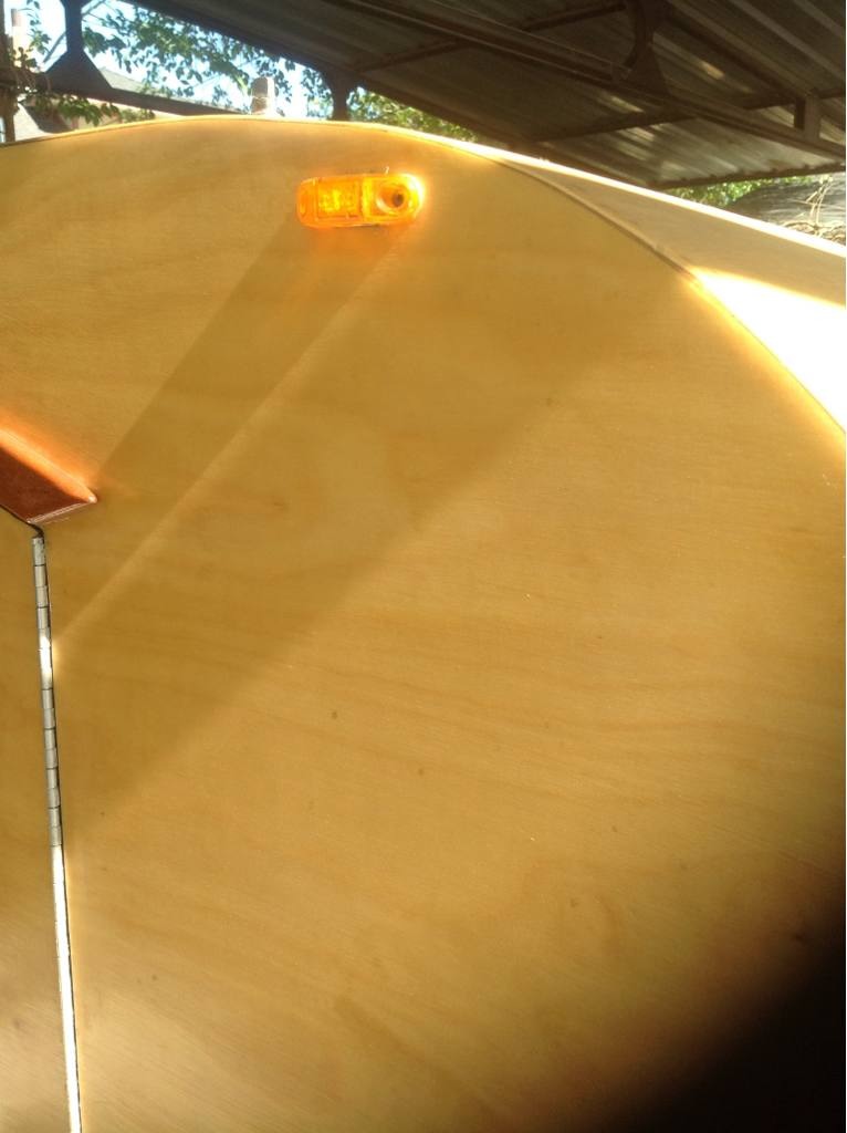

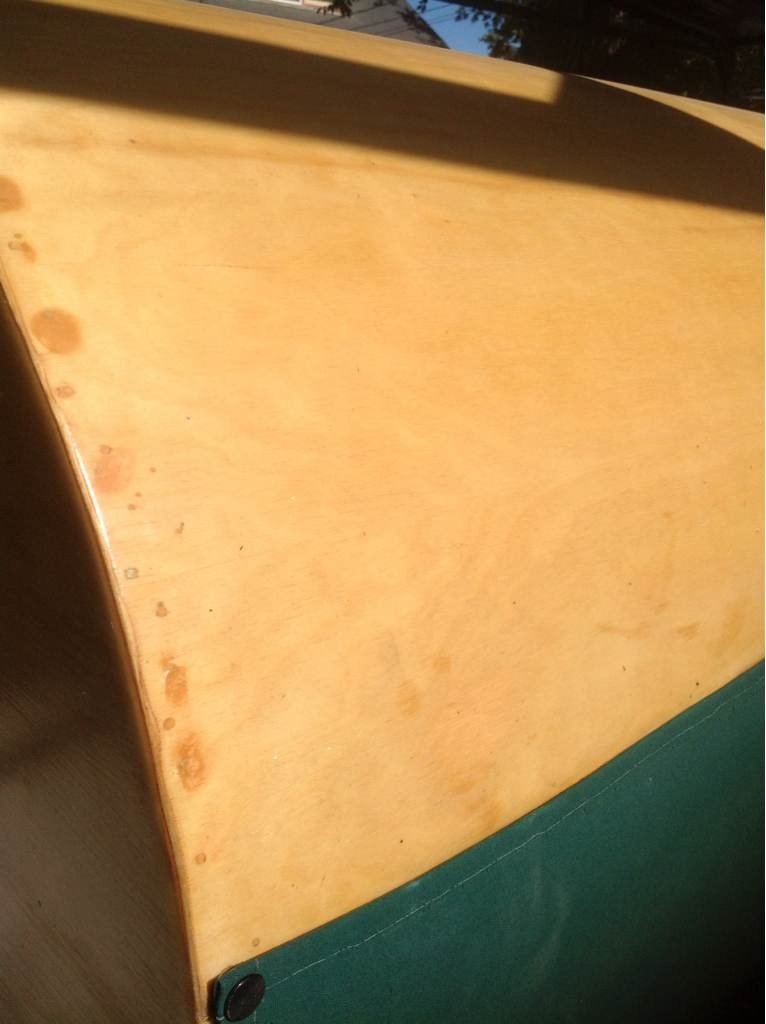

Here are some close ups the best i could. I hope you can see the glass really is transparent.
