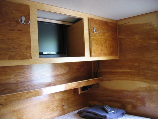

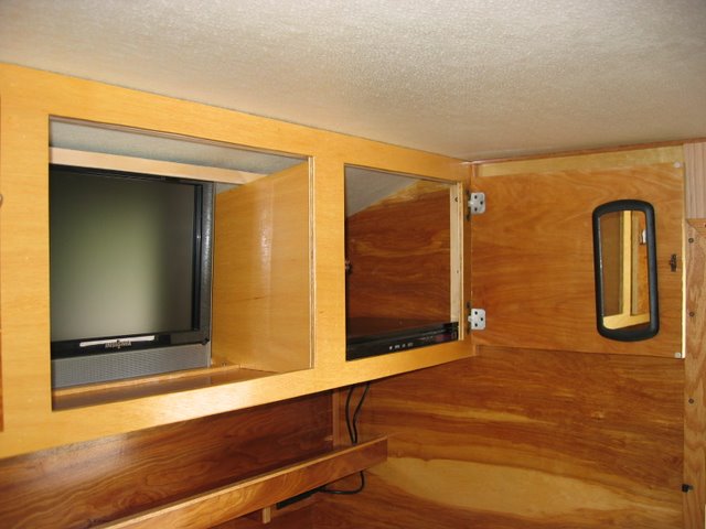

Got inside pics?

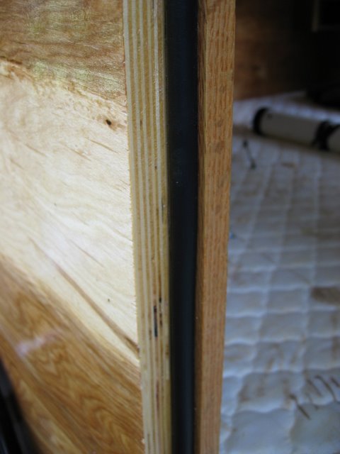

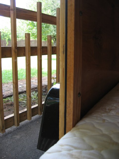

Also, how are your side doors set up. They look inset a little, or is that trim I'm seeing. Just wondered if you inset them to keep water from running in.

Here ya go caseydog. The doors are flush with the outside, no trim. I dadoed a piece of red oak around the inside to give it a pocket to close to and room for weather stripping.
That's a 15" LCD HD TV I got at BestBuys for $189.00, and in the cabinet on the right is a DVD player I picked up at the PX for $29.00. They work like a charm! The TV is easily moveable to galley.
