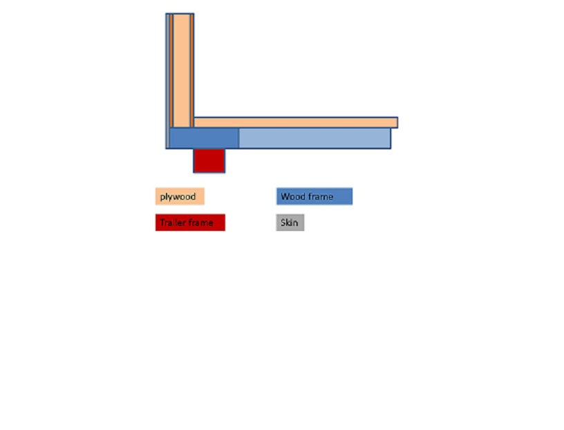

Postby markhusbands » Tue Jul 10, 2012 12:26 pm
What about this to save a little width and height at the same time?

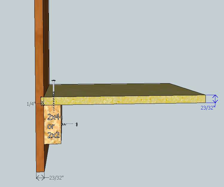

Re: Wall attachment options...illustrated!!!
Postby Fyddler » Wed Apr 10, 2013 5:51 pm
I am building a modified Campster 12 with solid 3/4" walls and 3/4" floor. I want the wall to extend below the wall in a single piece. This is what I have come up with. Does this seem reasonable? It will also be glued. Is it overkill to router out the inside of the wall?
