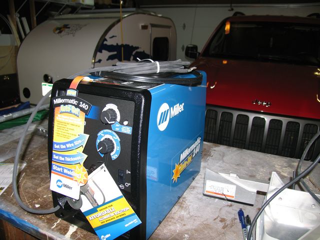

Postby bdosborn » Thu Oct 18, 2007 8:18 pm
Old Bill wrote:
Perhaps I went to the wrong place, but I was quoited a price in the $300.00 range for a MIG gas cylinder! And the cylinder was about 4-feet tall!
What kind of prices did you pay for a MIG gas cylinder? And, how large is it?
I just picked up a full tank of argon/co2, that size, for that price for my new welder. It will be $45 to fill it when its empty. I was pretty surprised with the cost too. Now I gotta get a cart so I can move all this stuff around.
