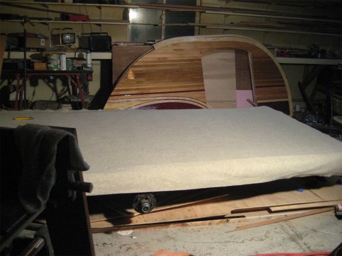

Thanks Starleen!!! I got some extra hands from the wife tonight and glued the liner on. It went well, and we were able to work out the wrinkles. Not being to smart about this...here's some observations...
    It took some time to get the wrinkles out from the folds...man it would be better to get the cloth rolled...
    I bought two big cans of that glue..and it took both of them. In Juneau, the glue cost almost as much as the fabric...
    I'm not so sure I would seal the ply beforehand again....that glue seems to coat things pretty well and it is water resistant...
I'm pretty pleased with the results. Here is the final pic...I'll trim the cloth tomorrow and call it a headliner!!!!
