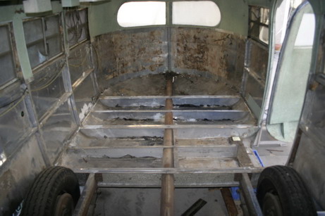

I have a little bit of work ahead of me.

our 46 Modernistic is all riveted .040 aluminum with very little framing. the door and galley hatch are double wall with wood between.
