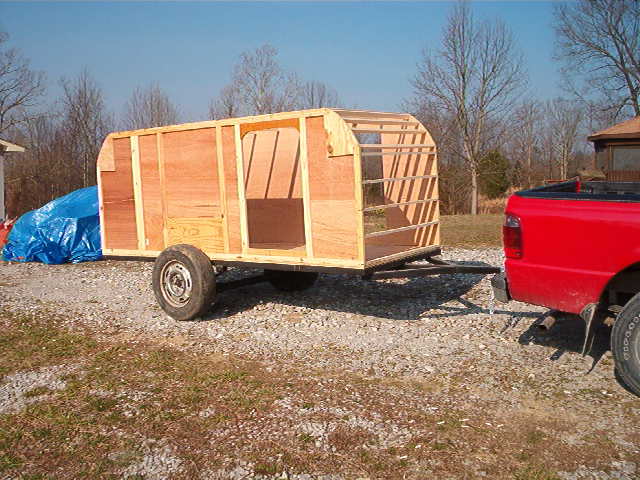

is 1/8" paneling a decent choice for the top? I was planning on using fiberglass epoxy and cloth on the top and sides. my sides are made of pine framing with 1/4" luan on the inside and outside. I just need to know if any one else has only used 1/8" luan by itself for the top. Should I use two layers of 1/8" for a total of 1/4"? I just want this thing to be strong and last for years to come. Don :thinking:

The only thing I can find in my area is wall paneling. I thought I would use two layers of it for my roof. I thought I could use a good quality construction adhesive to bond these sheets(F26 or liquid nails).I would install one layer and later bond and install the other layer. Then I would use fiberglass cloth and epoxy the entire body. Does this sound like it would be a good way to make my top. Don :)

I added more ribs this morning and now on my front they are about 7" apart. I'm sure the extra support can't hurt. I have the set them even closer on the curves. I have it in my mind that I only want to built this trailer once and do it right the first time(I hope!). thanks everyone for the support!!! Don :)Image
