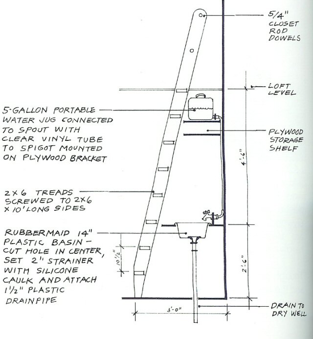

Postby IraRat » Tue Apr 12, 2005 2:51 pm
Okay, I'm a new builder, so illuminate me:
Water will seek its level, and obviously drop from a high point to a low point because of gravity.
So has anyone ever installed a water tank high in the galley, with a simple spigot to flow it to the faucet/sink below? If high pressure isn't an issue, and if trailering it with the weight of that water so high isn't an issue either (because you can always fill it on site), can't you get away without a pump?

Postby mikeschn » Tue Apr 12, 2005 3:27 pm
Gravity fed water has been discussed before...
The two biggest downsides to gravity fed water are:
1) Getting the water jug up there in the first place...
2) Towing a trailer with water that high up raises the center of gravity, increasing the chance that the trailer will roll over...
The best compromise was to put the blue poly bottle on the lower shelf of the galley, similar to what Dave over at Camp ADK does. I sent a CAD rendering of that to Jim in Sav almost a year ago, and I can't find it now. Jim, do you still have that rendering?

Postby IraRat » Tue Apr 12, 2005 7:09 pm
Everyone fails my reading comprehension test except Woody:
I'm NOT going to tow this with water in that tank. Just going to fill the tank when I get to my location
Hell, I'm not going the Sahara. Plus, this is America, and water is STILL free. (Of course, the way things are going, who knows.)
Second, getting the water up there is the easiest part of all. The container/tank is a constant up there, designed just for that spot. I'm not going to lift store-bought containers of agua up there--because any simple water pressure bulb and hosing will pump gallons up there in no time at all.
Finally, it will be a freestanding, easily removable unit for cleaning.
When I leave my campsite, just drain the water.
--Ira
