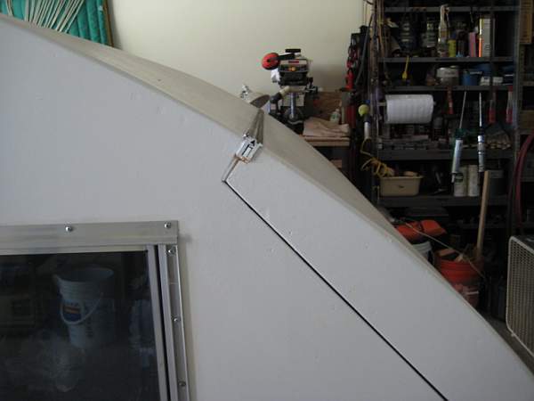

Postby alffink » Thu Sep 18, 2008 8:59 pm
The Huricane hinge is a very simple design that has held up in the industry for many years.
You do have to pay attention to the install though, it is not a standard hinge and you are not just hanging a door either.
Now I have to admit, that for the most part I followed Kevin Hauser's design, but the early users of this hinge would have it extend at least a quarter inch beyond the edge of the hatch and the edge of the roof.
Now, mine is cut to match the trim edge with a diverter to prevent direct egress of water,now I have not been in a driving rain, southern Cal hasn't had a driving rain in a couple of years, but I've tested it with a hose and it isn't wet in the inside. I have just loaded a few close-ups of the end of my hinge. There are better ways of doing this, I am sure, but this does seem to work.

Postby angib » Fri Sep 19, 2008 10:37 am
I think you're mixing up two things - hinges and seals. All the examples you give are where lots of thought (and some expense) has gone into designing and fitting good seals - in those cases, the hinges are not providing the seal.
The hurricane hinge is actually a stunningly simple device that works as both a hinge and a seal, has only one moving part and just screws straight onto two flat surfaces - something simpler and/or more effective is hard to conceive of.

Postby Arne » Fri Sep 19, 2008 12:24 pm
After running into the original problem of this topic on my first tear, I was careful to make the cut from the top/roof into the hatch area perpendicular to the roof line. The first time, I made the cut vertical to the ground, then realized the flange on the hinge was 90 degrees to the top surface.
This time, I made the cut 90 degrees to the roof. The cut slants forward a bit but the hinge fit fine. It goes a bit against the thought process to do it this way, but that is the way it is.
