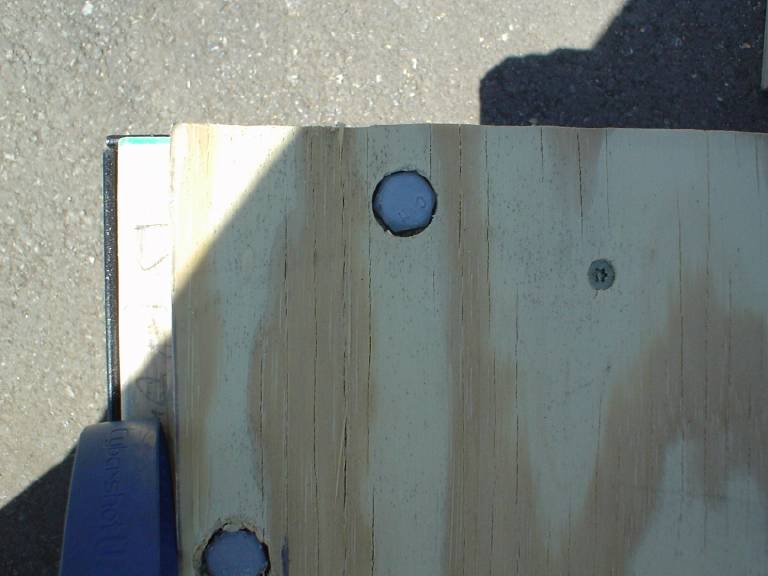

Since you are down inside the frame...how were you planning to attach you walls?
i stole from barb and made my floor 3/4" less on each side so the wall would be sitting on the wood framing.

hope barb does not mind me posting a pic of her floor she helped on..see the framing actually in the angle iron, then the floor on top is 3/4" less on each wall side so the wall sits on the frame. make sense now?

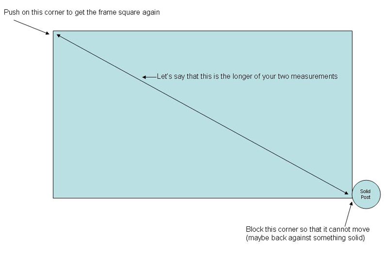

Mandy, if the frame is just out of square you can try this:
If the sides or ends are bowed you may be able to use ratchet straps to pull the bow in and straigten it.
