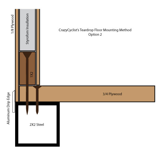

Here's option 2:

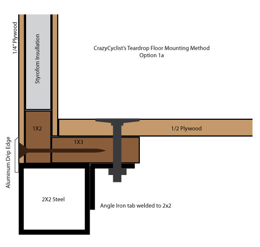

So Steve, you are suggesting something like this?
With this, I'm concerned about securing the walls to the bed. There's only 1/2 inch of plywood for the screws to grip into... Is that enough? :thinking:

Mel wrote:With this, I'm concerned about securing the walls to the bed. There's only 1/2 inch of plywood for the screws to grip into... Is that enough?
Mel, I have to be careful not to offer ideas over my pay scale...I'm building my first one...a newbie builder on teardrop time.
Your new 2a design looks better to me. It's similar to how my floor is bolted to the trailer frame. The big difference is that I have a 1-3/8" thick sandwich floor with countersunk bolt heads in the floor. I filled the countersink holes with epoxy to help secure the bolt heads and level them with the floor (probably overkill).
It may be iffy for a screw or bolt to securely attach a 1/2" plywood floor like your your newest 2a design. Probably a bolt head and washer above the plywood would hold, if you don't mind a protruding bolt head. (I would).
Sometime ago someone mentioned using elevator bolts that have a wide flat head. They might work well enough with good quality 1/2" plywood.
Or you might go back to your earlier idea of using a wood frame under the plywood floor to have more wood to screw or bolt through.

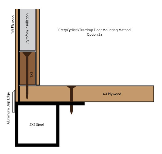

I don't usually get involved in these types of discussions, but I gotta tell you, your Option 2a is awfully close to the way I build my trailers ... except that I run my screws through the plywood and into the bottom of the walls. I build my bodies separate from the frame, and actually install the floor when the shell is upside down:
I also through-bolt the body to the frame through the (3/4") plywood floor and into corner bracket/gussets similar to what you've drawn in your frame diagram ... and I use Elevator Bolts ... never putting a fastener into the main frame, anywhere.
Before I roll the body back upright, I give the bottom a good coating of asphalt sealant and let it soak in and set for about three days. (If you think you might need to move the body around on the frame sometime after you've put it in place, I'd suggest that you take some black enamel spray paint and paint the floor bottom where it will rest on the frame members, thereby sealing the asphalt paint for a little while to give you a little wiggle room ... for a while. Once you bolt that body down, though, you'll have a great, water-tight, almost glue-like seal between the frame and the floor.)
Since you plan on doing some serious off-roading with this thing, I'd suggest going back and putting corner brackets/mounting tabs on the ends of every cross member of the frame and plan on putting a mounting bolt in each one.

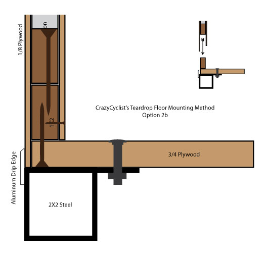

Postby crazycyclist » Mon Dec 15, 2008 4:16 am
I think I've come full circle with some great modifications inspired by the discussion here. I've come back to a variation of my original design. :?
I'll be using elevator bolts to secure to floor to the steel frame. I'll be putting glue on the screws to help ensure they do not reverse themselves with vibrations.

Mel, looks good. I have a suggestion for a minor change. As drawn your inside plywood is inset below the 1/2" plywood floor. My suggestion is to increase the 1 x 2 (nominal dimension) at the bottom of your wall to one with an actual vertical dimension of 2", or greater...so there's enough wood to attach the inner plywood to it. This is to allow the plywood inside the cabin to rest on top of the floor, not inset into it.
I imagine you'll bolt the floor assembly to the trailer frame first. Then you'll attach your wall assembly to the floor.

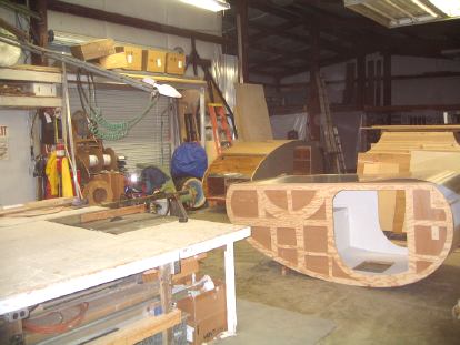

I am building my teardrop similar to Grant's method, but started with the floor first. This picture shows the first wall being attached to the floor. You can see the jig I built out of a piece of mdf to keep the wall square. My walls are glued and screwed into the floor.
I then attached the face frame for my front bulkhead cabinet, and the frames for my rear bulkhead. I also used a small jig made from scrap plywood to keep things squared up so I could add the second sidewall.
