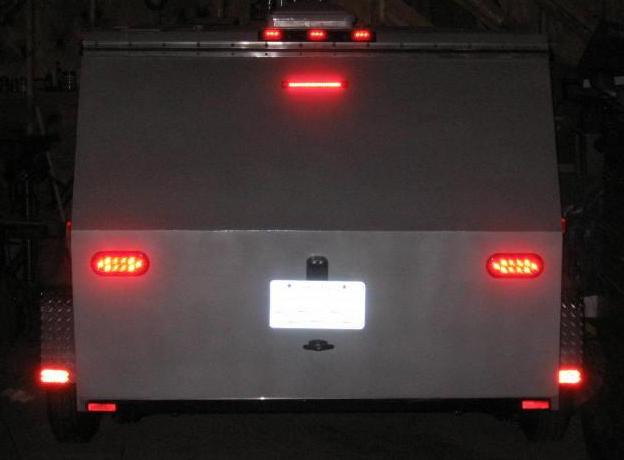

Good question! I do not plan to add the front ID lamps but did look up the Federal requirement. The short answer is the front and rear center ID lamps (amber, red)
are required on 80" wide trucks, etc., but on trailers only the rear ones are required. Turn signals are the same, on trailers only the rear ones required. Other lamps
not required on a trailer are backup lamp and of course headlamps.
The front and rear clearance lamps (amber, red) on 80" vehicles are required on trailers as well as trucks, etc. I believe having both the front and rear ones on the
fenders, facing forward and rearward, is good for a trailer if that is the widest point.
