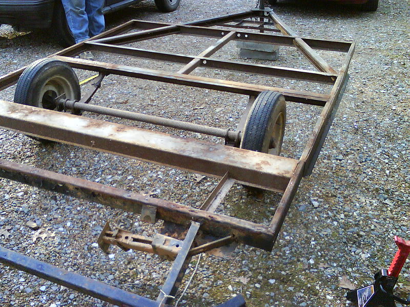

Mike..Im already havin fun. Scrapin rust an all. Ive got pictures but they are stuck in my phone till my daughter gets home with my micro chip. Gonna b tommorow. Just and ugly black trailer right now. Tomorrow it gets a new wiring harness and a deck. Right now Im watchin TV and figurin out where to put stuff. The trailer frame is 76"X94" so Im gonna over lap a lil to the front, that will set the wheels back more and give me some room for something special ;) I hope :roll:

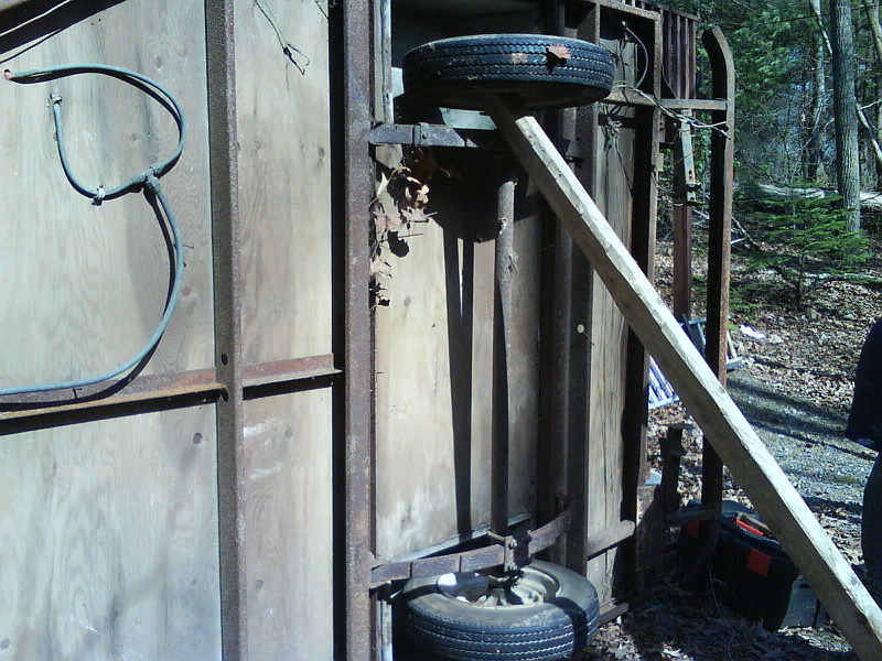

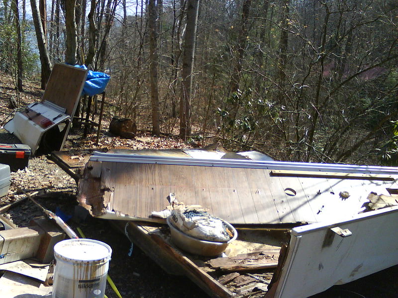

Postby MsDana » Sat Mar 14, 2009 12:53 pm
MsDana
Posts: 92
Joined: Tue Mar 03, 2009 9:42 pm
Location: Blue Ridge, Ga
Postby Geron » Sat Mar 14, 2009 2:49 pm
MsDana wrote::o I Think I Have Pictures!! 8)
http://tnttt.com/album_ ... c_id=47569
Lets see if this works....
http://tnttt.com/album_ ... c_id=47571
http://tnttt.com/album_ ... c_id=47570
You got pics. Way to go. I'll be watching your build. Been looking for a purple Tracker around BR but haven't spotted it yet - don't go to town 'cept when I Have To!
I have a trailer about that size and now that the "remodeling" is about done hope to get to work on a Standie and the Play Mor.
What do I need two more trailers for -- but that's not really the point, Is It?
Keep postin' the Pics. :applause: :applause:
