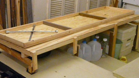

Well, it's been a while. In spite of spring chores and honey-do lists, I've managed at least an hour at least a few days a week. It's still a ball, especially using up junque I've had around, some since dirt. Until today I've preferred to spend what time I had on building, not strugging with posting pictures. If I fail at that again, please exert the effort to click on "Album."

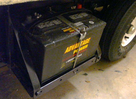

The fender wells and multi-position bed were done last week, and this past week, the entry step and battery mount, which I then raised to match the steps, allowing me to "raise the skirts" for a more-proportional look and a bit more clearance. I've ordered windows and begun to settle on a shape, even scored a yard sale jig saw for $5.
Fans of the HF 4x8 may recognize the bumper brackets as the HF stake pockets, the step brackets as the HF fender brackets, and the battery box main rails as the HF "kick stand" rails, sans dolly wheels. The 3/4" ply at the ends is from an old flatbed box once built on a jet ski trailer. The rest is a mix of 1x2 and 2x2 and 3/16 and 1/2 ply from and a shanty boat cabin I never finished and a retired mower shed.
Knocking that apart surely proved what I've seen here, that most folx overbuild and that TiteBond is excellent glue! The top ply of most panels ripped off and when I laid one slightly arched 4x8 roof panel on the floor, took out all the screws, and literally jumped up and down on the center, one laminated 1x2 broke and everything else just held tight and smirked.
You may notice detail changes between shots of the folding bed, the result of a whole Saturday of fiddling with angles and set-backs. The odds and ends underneath are tentative "utilities" and temporary legs.

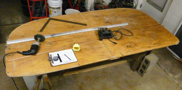

Postby Barefoot » Sat Apr 25, 2009 9:02 pm
Well! At last I settled on a profile and made that first scary cut, so have a template and await a router on order. I traced along a bendy piece of plastic trim, held according to co-ordinates from my rough plan, partly by hand and partly by brads. The sharp curves in the lower profile are for the bottom 2x8 side panel and don't involve any panel bends.
Note my yard-sale $1 framing square (replacing the un-square small one) and $5 jig saw. The latter is two-speed (too slow or too fast) but between both tools I'm making much neater cuts! Note also my long aluminum straight edge, trim from between two windows and the best I've ever used.
I've lived in travel trailers 17-36 feet long for extended periods quite a few times and came to prefer crank-out windows to house windows. These are flush-mount 16x24 from Atlantic Shed, www.atlanticshed.com at $35 plus about $9 shipping each from MA to FL, depending on how many. Sorry about the electronic speckles; it was darker in here than I realized.
The tire came and is the right one, and is tucked under the the bed platform. I used long carriage bolts and wing nuts so as to not need any tools besides the lug wrench you see and the car's jack, and I wasn't comfortable doing that if it were hung under the trailer.

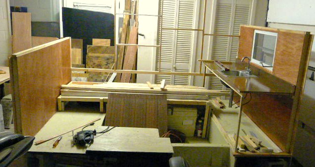

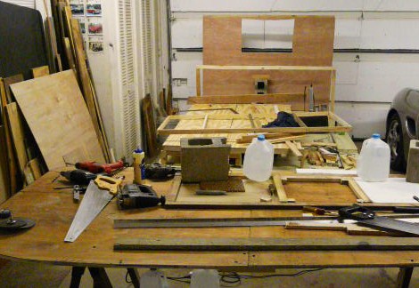

Postby Barefoot » Sat May 02, 2009 7:00 pm
WELL!! At long last I got many of the pictures to open by finding and trying Edit --and other folx had alredy gotten some of the others to open. Thank you both.
This week's photo is of the moment I decided to knock off after a long, productive day. It was about the dozenth time I'd thought, "Dammit, it was Rigt Here just a Minute ago!" Because of glue drying time, I'd wound up with stuff piled on stuff from working on the front and back wall and galley all at once,, much of it twice, as a good bit of it has been, uh, learning experiences. It is still a ball, though.
The counter top is a gogeous piece from one of those short closet doors from above the wheel well in an old trailer. I even sprung for some of my new wood on the cabinet face!

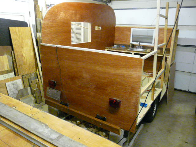

Postby Barefoot » Sun May 31, 2009 6:40 pm
"Auntie," thanks for the tip on the knob to replace the long window cranks. The center screw looked easy to replace with a shorter one but I'd wondered if the "teeth" to fit the ones on the shaft would be the same for a knob or if I'd have to epoxy something. I didn't get to it anyway, but it's been a productive week, even slowed by a day of researching 120 wiring and and a day of puzzling out how to run it. Sure did drill a lot of holes I won't use. The 12 volt will be familiar.
Building from the inside out also makes progress seem slow, but suddenly the pace seems to be picking up. I got the side wall (where most of the wiring will be) skinned, finished, and mounted. Today I cut all nine remaining panels (unh) and installed a few more. I'll not have to buy more paneling and will have little waste, but that's enough schemi... thinking for one day. I like having made a pattern for the little $23 trim router if I never use it again.
If seeing the tail lights light up didn't make it seem real, stepping inside to work on something at the galley really made it seem like home, however tiny.

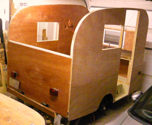

Postby Barefoot » Sat Jun 20, 2009 7:12 pm
Progress seemed to pick up this week, as I got both side walls finished and installed to stay, skirts, bracing, wires, insulation, curved framing, even the door header. It's beginning to look like a proper TTT and a cute enough hall / haul for Mr. Toad / Towed. Still no worse than 1/4" off anywhere, though there are a few of those.
I was going to do the roof next but we're having very near 100 degrees every day, 90 in the garage, so I'll leave it off for ventilation while I do some finishing and interior work.
