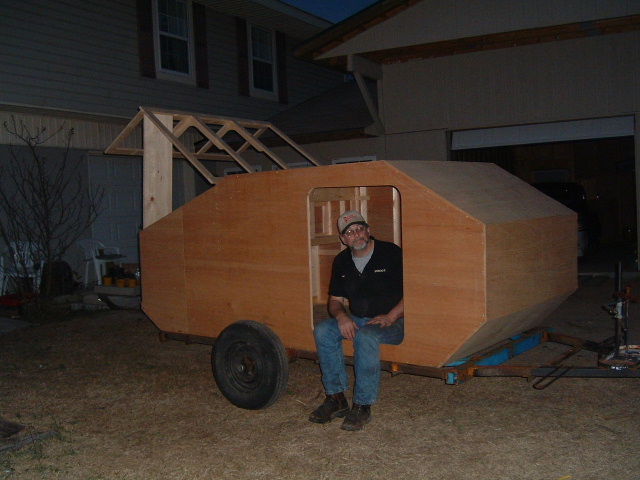

Postby mikeschn » Thu Apr 07, 2005 3:41 pm
I'm building a couple walls for Bev this summer. I'll do some weight comparisons as I go...
If I had to venture a guess, those 36# walls would have weighed 49# with insulation and inside skins.
A sheet of 4x10x3/4" plywood might weigh almost 94#. Every pound helps.
SteveH wrote:Mike,
The picture of the wall that weighs 36 pounds is not complete. It does not include the insulation or the inner skin. Have you ever weighed a simular wall with all included? Granted, the insulation would not weigh much, but some, and so would the inner skin. Just curious about what the complete wall would weigh. :thinking:
P.S. The reason I never weighed the completed wall, is because it was never completed. I switched gears and moved on the the Lil Diner. Frank is finishing up the Weekender...
