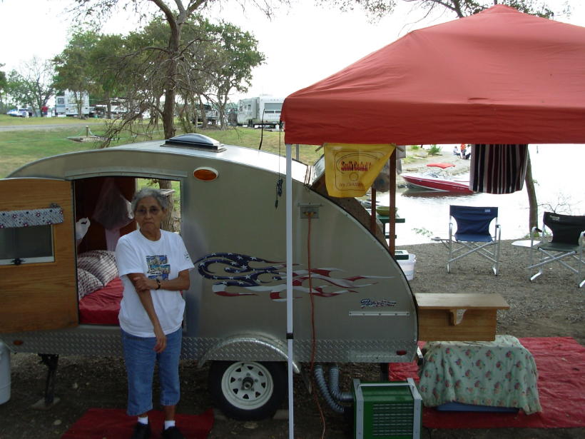

Intake & return air ductwork for the Petcool AC/Heater :thumbsup:
Trial run set-up at home
At Lake Texoma campout last August - 95* plus, worked great ;)
