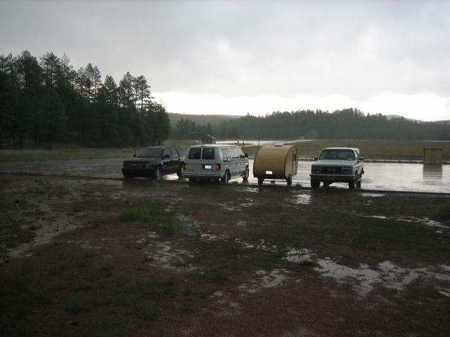

Postby wannabefree » Tue Aug 25, 2009 11:21 pm
Took the Paskett Case up to the Mogollon Rim last weekend. Had a thoroughly enjoyable time. Got a little rain, so the tear was rain tested.
Aside from fixable leaks all went well.

Postby S. Heisley » Thu Aug 27, 2009 11:42 am
WOW! :o Looks like it was plenty wet and a good test for leaks!
Thanks for sharing the pic! :applause:

Tried backing into the driveway (in the dark) when we got home. Almost a disaster; couldn't see where the trailer was going. Came within half an inch of crushing the front right corner of the tear.
Was this backing through your mirrors? Don't back a trailer by looking over your shoulder; that's bad practice. Use your mirrors; they're big enough. Also, always first walk a new or unfamiliar approach to check for hidden hazards.
Adjust both mirrors outwards bit by bit until you cannot quite see any of the van's sides; this will give you the widest field of vision. While backing, check both mirrors at regular intervals...
If while backing the trailer begins to move to your right, or, towards the curb/passenger side, think "right = losing your light". Then say to yourself "if you're losing your light, turn right", steer to the right, and that will bring the trailer straight again.
Once you practice this, you will react in kind when the trailer veers to your left; your steering response will become more natural.
Also, set an "arch" and trust that the degree of the van/trailer arch will stay put as you're backing if you leave the steering wheel alone. Don't overcorrect.
Practice, practice, practice! Get a couple of orange cones and practice in an empty parking lot.
Good luck! Your tear is beautiful. :cheerswine:
