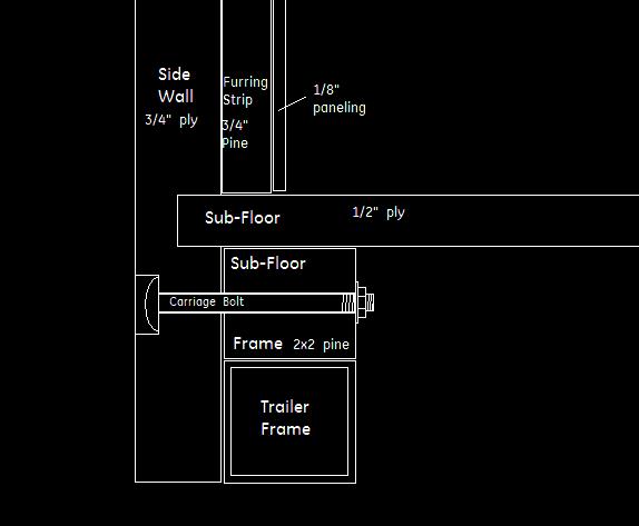

How does this look? If I use 1/4-20 or 5/16-18 carriage bolts, they have a tension strength of something like 60,000PSI, and shear strength 60% of that. Three bolts per side should do it.

Postby kennyrayandersen » Tue Aug 11, 2009 5:21 pm
alanv73 wrote:How does this look? If I use 1/4-20 or 5/16-18 carriage bolts, they have a tension strength of something like 60,000PSI, and shear strength 60% of that. Three bolts per side should do it.
I'm not real sure why you couldn't eliminate the sub floor frame and bolt right to the trailer frame (assuming the trailer frame has the intermediate supports that your floor needs. You could use some construction adhesive to smooth out any low spots. This would save you a couple of inches of interior height and still cover the frame.
It's not really much of a strength issue with the bolts -- just having them is enough. If you can use bolts that have only threads at the end (not all threaded) so the solid shank is in bearing (good design practice).

Postby Mauleskinner » Fri Aug 14, 2009 7:20 pm
kennyrayandersen wrote:I think it boils down to whether you used enough fasteners/glue in the first place. The problem was with a commercially produced teardrop, and it was noted that there was a scarcity of fasteners in the joint. If you screw and glue/biscuit or glue/dowel, I’m guessing you aren’t going to have any problems whether you bolt the side wall to the frame anyway, I was just noting that it would definitely eliminate this failure mode and it does make an incredibly strong joint.
That's probably the case...I've had pretty good luck with thickened epoxy for various applications, but strategically placing some trim with a few lag bolts probably would be good insurance.

Postby alanv73 » Fri Aug 14, 2009 7:33 pm
To make me even more paranoid :?, I was reading a thread about adding shock absorbers to a TD. Not that I'm considering it for myself, but I just thought it was interesting. There I read some horror stories about the amount of 'bouncing' these TD's do on bumpy roads. All I could picture were those carriage bolts shearing off on my way to my first camp-out.
cya,
Alan

Postby Jst83 » Fri Aug 14, 2009 7:46 pm
Just my thoughts, Why are you going with the 3/4" outside wall I'd go lighter and make it thinner.
Mines held onto the frame with Liquid nails and sheetmetal screws through the 3/4" sheet of plywood into the metal frame and about 6 down each side into the sides. It's 6'6"x11'6", 1,720 lbs and has over 3,500 miles and 3 years on it with no troubles.

Postby kennyrayandersen » Fri Aug 14, 2009 11:27 pm
alanv73 wrote:To make me even more paranoid :?, I was reading a thread about adding shock absorbers to a TD. Not that I'm considering it for myself, but I just thought it was interesting. There I read some horror stories about the amount of 'bouncing' these TD's do on bumpy roads. All I could picture were those carriage bolts shearing off on my way to my first camp-out.
This is why I'll go with a torsion axle as it not only springs, but damps.
Really though, unless you got some pretty rough roads a regular spring set should work OK.
BTW most of the load is always down, but 3 or 4 lag bolts per side would be HUGELY stiff and strong. The wood would fail long before the bolt does. :thumbsup:
