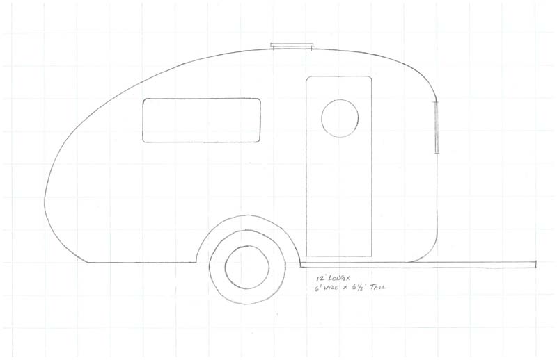

I drew out a sketch last night, the old fashioned way (pencil and paper), so I am going to try scanning it and getting it into digital format to share. I went with a profile similar to the JD Hunter. I didn't want to waste the work that I have already started on my chassis, so I designed something that, hopefully, will work with what I have so far. It ends up being a little longer than 10', actually came out to 12' long, so it will be nice to hear what people think. Also, the wheel may need to move a bit forward, hopefully I can get some advice on this. I am a little concerned that with the galley toward the front, the weight may be too much over the tongue area.

Wow Mike!! That looks great, and it is really darned close to what I was thinking, except that I have the front a bit flatter, like a Benroy. I am going to try scanning the profile here in just a few minutes, so I'll see if I can get it posted within the hour.

Mike, I posted my sketch of the profile in my gallery (http://www.tnttt.com/gallery/image.php?image_id=1339). Just needs a tongue box on the front. My chassis frame is 115" by 48", so I wanted to be able to build around what I already started. What do you think? Pretty close to what you have drawn, but a little taller. The wheel area is a little rough, since I was freehand drawing it, but I think you get the idea. I'm looking forward to some feedback on this.

Postby mikeschn » Fri Apr 29, 2005 12:51 pm
Hey Amy,
That's not bad... I see you have a flat floor instead of a dropped floor. That means you'll need a much larger wall, probably 6'. You'll have to build up your wall from multiple pieces of plywood.
I tried to stay inside a 5x10' piece of plywood, but since you are trying to use your existing trailer, my smaller design wouldn't work for you. But you could stretch it out lengthwise...
How tall do you need it at the doorway?
Postby AmyH » Fri Apr 29, 2005 1:02 pm
Mike, I think the doorway just needs to be tall enough to get in, so if you need to bend over to step in that isn't a problem for me. I am 5'7" myself, so I figured that somewhere around 5' tall would be fine for the doorway. What do you think? For the sides, since I went taller, I figured I would butt 3 pieces of plywood side to side to get the length and the height. Seems like a little bit of a waste, but I figured that I might be able to use cheaper plywood, since I will probably skin it with something, just not sure what yet. Do you think, proportionately, that the design will look too tall in comparison to the width? I like the length to height ratio, it looks pretty good, but I am concerned about the width to height ratio.

Postby mikeschn » Fri Apr 29, 2005 1:10 pm
Okay, you're 5'7". That means you need 5' 9" of clearance to the ceiling.
Since you are using 3 sheets of plywood you could easily make it 6x12'. But that's huge! And it's going to be heavy. What is your tow vehicle?
