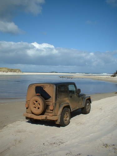

Imagine what a bike mounted externally would look like after 8000 miles of this (and worse)?:
I can imagine needing a $2000 overhaul if I tried that. Riding a bike doesn't get it anywhere near as dirty by comparison. Now of course, you could use a motorcycle cover, but that's not much fun when it's covered in mud. It's also difficult to lock a bike that's well covered, and vice versa.
I did consider the mounting a rail across the A frame for the wheels to sit on, then a hefty post to mount it too. Press studs and a heavy duty cover could seal it all in, and it wouldn't be immediately obvious what's underneath.
