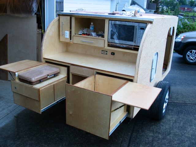

Postby paddlehead » Sun Dec 06, 2009 10:43 pm
Here are two pictures of our galley slide outs. The left side holds the camp stove and has pots and pans in the cabinet below. The right side originally was for the Igloo TE cooler, but we now carry an ice chest in the car and use the big slide out bin for storage of food, a portable BBQ, etc. Both slide outs also have flip up counters that really come in handy.
The slides are side mounted, 100# rated from Home Depot. You can see them located along the bottom. They slide out a full 24".

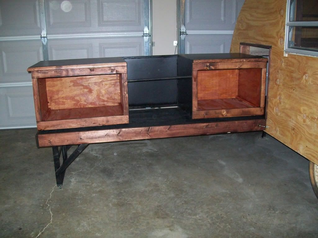

Postby neil and ramona » Fri Dec 11, 2009 5:36 pm
the slide is just a table of sortsImage
here is a picture when we were just getting started there are better ideas out there but this works great fo us :thumbsup:

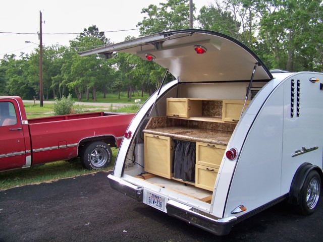

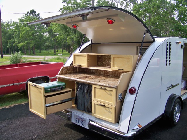

Postby Carter » Mon Dec 21, 2009 7:25 pm
Small but works for the two of us in a standy. All the pans, dishes, utensils and flatware store in the drawer along with foil and Saran wrap. 2 burner range and sink with hot and cold running water on the top. 600 lb capacity 36" full extension drawer guides from McMaster Carr are rock solid (and expensive). Icebox and food storage inside the trailer.

Postby aggie79 » Thu Dec 31, 2009 10:04 am
Carter wrote:Small but works for the two of us in a standy. All the pans, dishes, utensils and flatware store in the drawer along with foil and Saran wrap. 2 burner range and sink with hot and cold running water on the top. 600 lb capacity 36" full extension drawer guides from McMaster Carr are rock solid (and expensive). Icebox and food storage inside the trailer.
Jim
Jim,
I really like this set-up. Without hijacking the thread, can you say what type of seals you used to seal the slide-out in both the "in" and the "out" postion?
