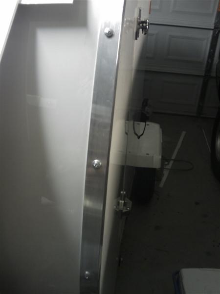

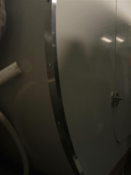

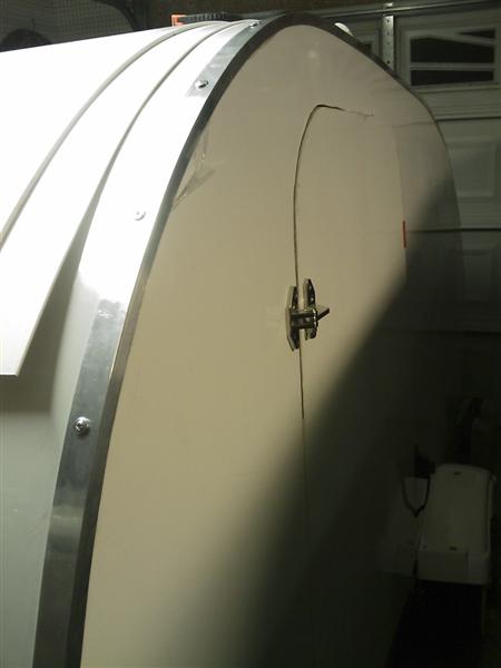

Postby Rusty drop » Fri Jan 29, 2010 11:08 am
As promised, here are some pics of the trim molding that I end up using.
I cut 1/2" on one side of the angle for it to be more flexible,, it was kinda of scary to cut aluminum for the first time... but after some sweat bending it to shape and being so careful not to kink it, I think I got it right.
(I actually did kink it once...) :x
It does not have the seal yet.
also wanted to share what I did with the Marine hinge for the doors. I have seen some posted here, but did not like the idea of being so accesible to remove the pin and have acces to remove the door.. I used some SS bolt and nut, got it tight enough for the hinge not to have so much play,, a couple of sprays with WD40 and it worked out really good...
Thanks.

Postby BigAl » Sat Jan 30, 2010 4:19 am
Good job Rusty! What was the gage of the angle that you used? Does anybody have thoughts on it being possible to pre-heat the angle to make it easier to bend without kinking?
