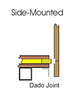

Check the following link for various methods of attaching the walls to the floor: http://tnttt.com/viewtopic.php?t=19442
I'm using a Dado in the wall, but my floors extend beyond the frame, so my method isn't pictured on that link. Here's what mine looks like. The grey angle you see pictured does not run the full length. They are actually about 2-1/2 inches wide. I will be using 6-8 down each side as additional bracing.
