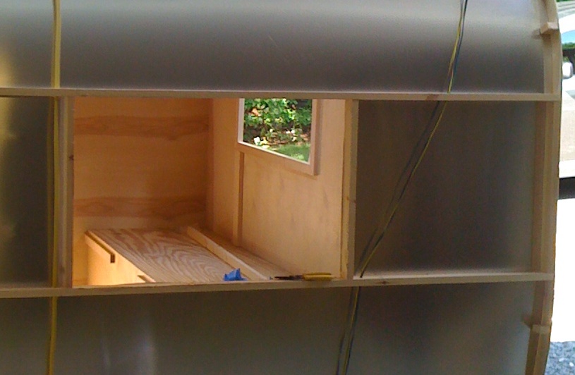

Postby karch67 » Sat Mar 13, 2010 4:16 pm
I used 1/4" birch for my sidewalls with exposed 1x2 framing around the windows, doors, and seams. Used 1x2 roof spars and covered the whole trailer in .032 aluminum.
