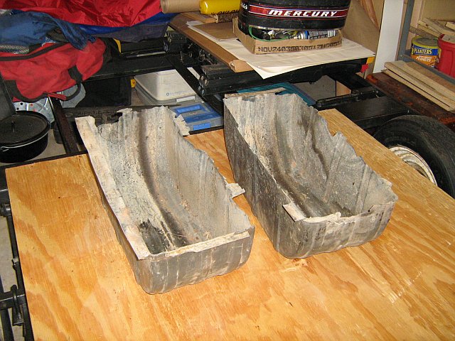

I'm a firm believer in being able to learn from others mistakes, so thought I'd add this pic. (I'm using a pop-up chassis and parts)
You may be able to see a lip on the perimeter. That was stapled to the underneath of the floor decking. The plastic was very thin, IMO, and became brittle with age. Where moisture was able to get through the cracks and then onto the flooring surface was where the rot occurred.
Incidentally, the plywood flooring wasn't treated with anything underneath (no tar, no pan) and all areas that were able to "breathe" and gravity drain were completely intact.
Last evening I built plywood wells from my flooring cut-offs. The scraps were already treated with tar and were too tempting not to utilize. The wells will be used as support for other structures, so I needed something sturdy and the plywood fit the bill. They will be surface mounted. At all interior joints and on all edge grain I over-sprayed with a shaker can of auto body undercoating (left over from another project). I'm hoping that the combination of surface/edge-grain protection and gravity drainage will suffice.
I really like the plastic barrel idea. Some great info., thx.

The pics of the fender boxes also make a point for AFREEGREEK's suggestion that the end grain of the floor plywood not be exposed and that the box fender well box extend a bit below the floor. Easier to replace the box should it become damaged or rotted due to the end grain being exposed than the floor.
