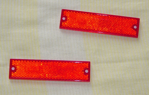

In the states your turn signals can be Amber on a trailer but don't have to be.
Most of the oval, surface mount LED tail lights do not have reflex, so you need to run a reflector strip of some some, lucky not a big triangular one. We use these 4 3/8" x 1 1/8"ones.
