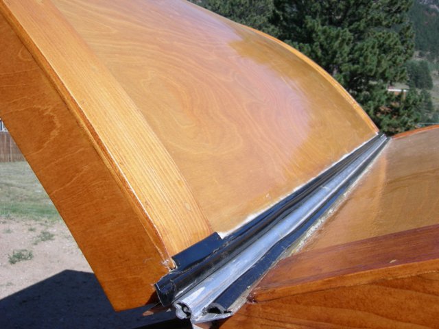

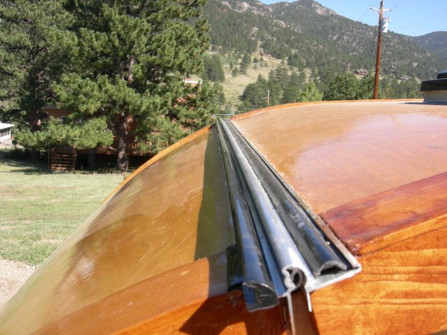

Postby EPGregg » Wed Aug 25, 2010 5:27 pm
I just got back from a rainy trip and tried our "Galley Cover". I had the same problem. As soon as I got back checked the trusty TTT website for solutions/simpathy. I concluded that the leak is a function of the design of the hinge, it's just made to work properly when closed (and it does). My possible soulution, to at least reduce the problem, is to install some EZ gutter (from camping world)on the lower side of the hinge.
http://tnttt.com/album_ ... c_id=70096
http://tnttt.com/album_ ... c_id=70095
Lets hope it helps!
