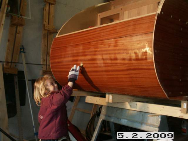

Postby Rock » Wed Aug 04, 2010 5:07 pm
You could hire a 3 year old that works cheap....

Postby glassice » Wed Aug 04, 2010 5:33 pm
Man I hope that was a fast shot the fumes can mess with DNA harts lungs the hold body . and most of the time you get a rash is your reacting to the resin it be better for the kid to be in a meth lab not get on you but what thy done to me :?

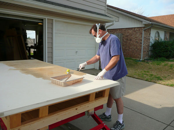

Postby aggie79 » Thu Aug 05, 2010 8:09 am
I believe in the use of respirators and gloves when epoxying. The respirators are a little expensive - the ones with the organic vapor (charcoal) cartridges - but in my book they are cheap insurance.
BTW, you probably don't want to do what I did in the picture above - applying epoxy in the heat under the sun. I was just sealing the bottom of my floor so when I had some air bubbles from the rising heat and the sun, it didn't bother me.
