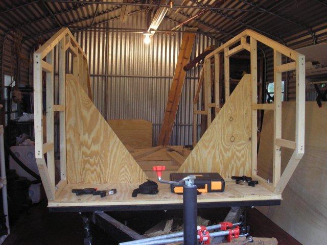

I built my frame on the workshop floor then carried it to the assembly shed. You can see that the wall framing was bolted to the floor and frame then the skin was applied.
