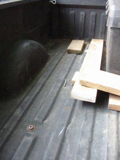

Lets see if I can get this to work right. This should be my Line-X truck

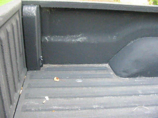

And this should be my neighbors Herculiner.
The white spots are where the Herculiner has worn through or off. I don't know what he paid for the Herculiner, but I'd have to save a HUGE amount of dough to have to reapply every couple of years to keep the protection.
Note that both or the trucks have a dent on the wheel well, I know that dent happened after application on mine, I think his did as well.
One other thing is that the texture of the Line-X is "softer" it still has a non slip grip to it, but the Herculiner feels like 40 grit sandpaper.

I just want to reiterate that I can't vouch for the prep work on my neighbors truck. I would hope that he followed directions but I wasn't there to hold his hand.
On the other hand, we are talking about applying it to plywood, not the sheetmetal it was designed for

Woodsmith, it sounds and looks like your neighbor applied the Herculiner too thin which is a draw back to their kit. There is not enough product in a kit to properly coat a full size pick up box. He should have purchased another quart to finish the job. For that matter, what you paid at Line-X he could have put three coats of Herculiner down. The reason for the sandpaper gritty finish is probably from him trying to spread the Herculiner out and get it to stretch far enough to cover the entire bed, the roller that comes with the kit is like a sponge and as the coating dries it will leave a rough and coarse finish. So it sounds like to me that he tried to stretch it too far and for too long.

Well i would like to stick up for Herculiner as now I have some first hand knowledge on the application and have talked to some friends that have used it in their trucks. It is all about preparation of the surface before application! Line-x and Rhinoliner is the same way if they are not properly prepped it will not adhere to the surface. The other issue is about amount of product....you have to use several coats and then touch up areas you missed or it will look like your pictures.. what I do like about it that if you do damage it you can fix it right on the spot damage without having to scrape the rest of the material off and reapply the whole liner. My .02 cents.
