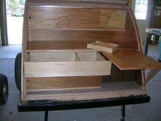

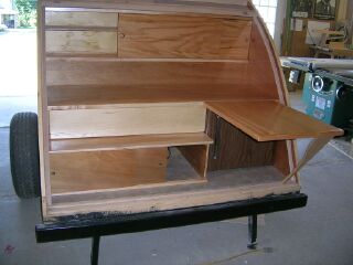

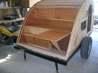

We finished our galley today. Just need to get a lock and drawer pulls. Here are some pics
The table and leg are hinged and fold up
Mini fridge underneath counter
Lower cabinets have sliding doors and hold the gas grill on the left and the gas coleman stove on the right
Upper cabinets also have sliding doors and a shelf on the left side
The drawer has full extension slides and we can fit pots & pans on the left and utensils on the right. There is also a lift out silverware tray.
We have seen some great galleys and wanted to share ours with you all.
