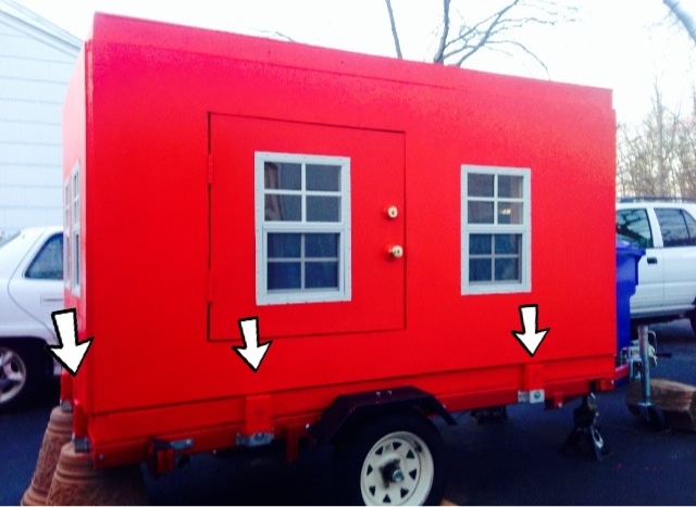

Mine is attached in 8 locations around the trailer frame. Can be unbolted and removed.
