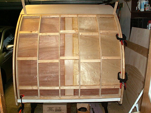

Leave it to me to do it oddball. 5 ribs on a 4 wide running fore-aft with cross pieces screwed in.
As this is an ultralight I used 1/2" Baltic birch plywood and no inner skin. If you have access to both a jigsaw and a router I suggest making a template out of 1/4" masonite and using a template router bit (with a bearing) to cut all your ribs the same. This way you can spend a lot of time sanding the template right to the line, and you can be a little sloppy (fast) with the jigsaw, and remove the last 1/16"-1/8" from the ribs using the router with a template bit and your Masonite template. I think I used a bit with a top mounted bearing, used double stick tape to hold the template to the spar blank. Use clamps to clamp the template/blank sandwich to the bench, trim about half the spar to the template, flip the blank around, re-clamp and finish.

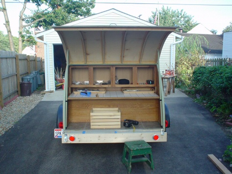

I went vertical:

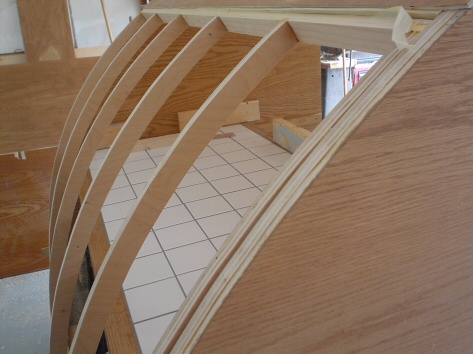

I used 5 ribs, no hint of spring back.

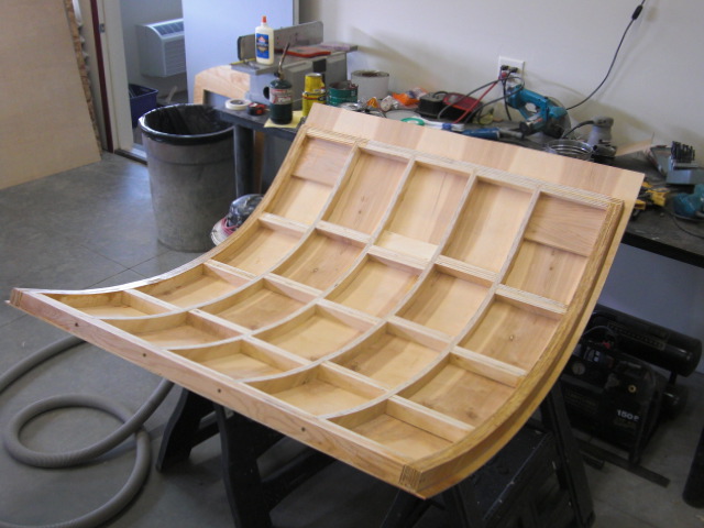

Just remember, you'll have to lift however much wood you have in the hatch every time you open it unless you have some "lift assistance" such as some of the gas filled hatch lift struts some here have used. I wish mine were not so heavy with its 6 uprights and cross braces. On the other hand, spring back is a non issue.

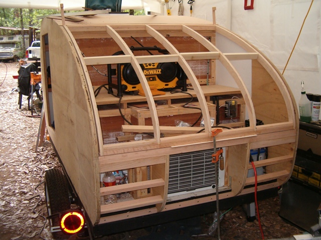

I made ours WAAAAYYYY too heavy. :( 4 3/4 x 1 1/2 ribs 2 1 1/2 x 1 1/2 on edges with 1 1/2 square cross ribs. covered with 1/4 plywood then .040 alum. and 1/8 masonite on inside
Image[/img]
Thinking about building another that isn't soooo heavy. :thinking:

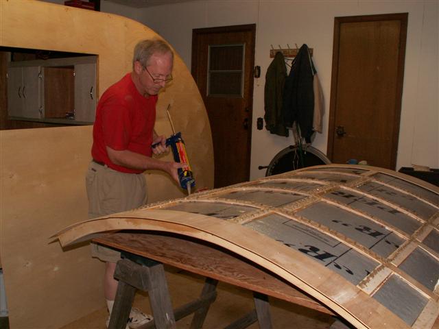

Well, yes, I did insulate my hatch and finally found a pic to prove it. Seems to me if the rest of the build is insulated, then the hatch ought to be insulated also.
