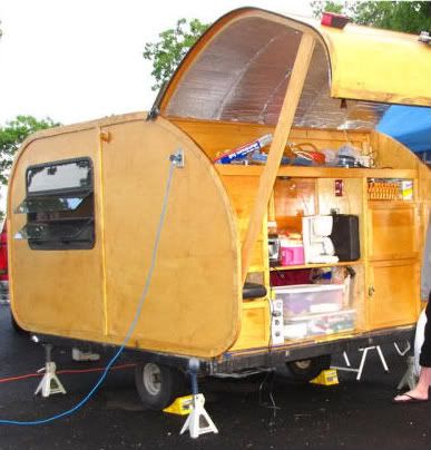

I got some garage sale jack stands for $5 each. They are harder to get exact than a screw type but cheap and they work.

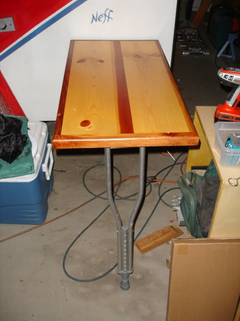

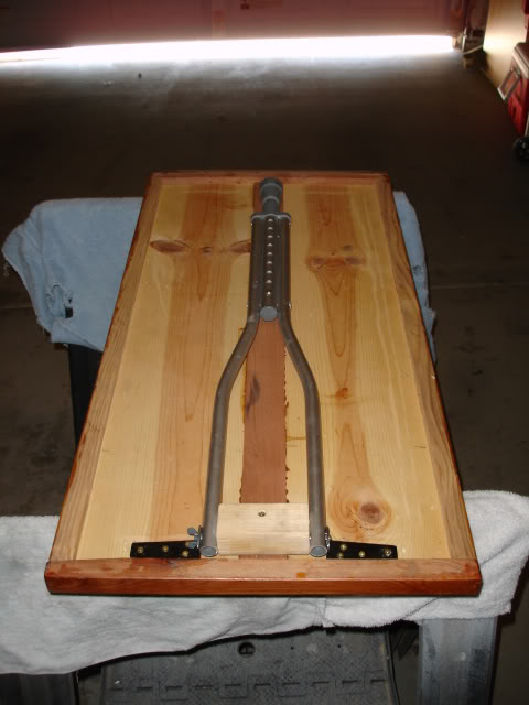

Dan & Julie CO wrote:I was thinking in terms of something made or repurposed
I have seen a crutch made to be used as an adjustable table leg :designing:
If your trailer has a tongue jack all you really need is a stack of lumber. With the nose of the trailer low in front Block the rear to level and crank up the tongue jack to where it is slightly high in the nose then block the front at either the tongue or both front corners. Lower the jack and you are as stable as if you were on a concrete foundation.
I was lucky and hit a yard sale and purchased 3 scissor jacks for $5.00. Yep all 3 for $5.00 ! :D
Later I found those aluminum screw jack stabilizers at another sale for $2 each bought 4 of them. [ same guy had 12 volt and 120 volt ac on demand water pumps for $5.00 each I bought both]
However for the life of me I can't see a crutch as a table leg :roll:
o.k. o.k. ya caught me Image
but I have to give credit for the idea to Handyman Dan who I stole the idea from
However I gotta hand it to Cliff he has perfected the hinge thing to make the folding leg work great !

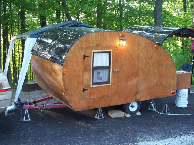

Postby bobhenry » Thu Feb 24, 2011 8:11 am
I have cussed mine and hauled them around loose in the bed of the truck.
Stupid me never thought of taking out the screws and nesting them :oops: DUH!
I'm gonna look around in the garage and find one of those camp chair sleves that never seem to get the chair back in them and nest all the parts in one of those.
here is 5 on the ground ( all 4 corners and the tongue) and a spare setting in the foreground.
Guess I thought I had BIG plans that night ! :D
