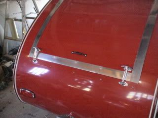

Aaron Coffee wrote:Here is what I did for mine
closeup
Bought these on ebay (will post a link later)for $6 each or so. Not lockable but I am thinking of adding a barrel bolt lock, or a slide lock on the inside of the hatch, I have a pass through from the cabin to the galley I could reach through to unlock it, or I might not put a lock on at all, I don't usually lock #1, not even sure where the keys are. Anyone of dishonest thought please disregard the previous sentence.
