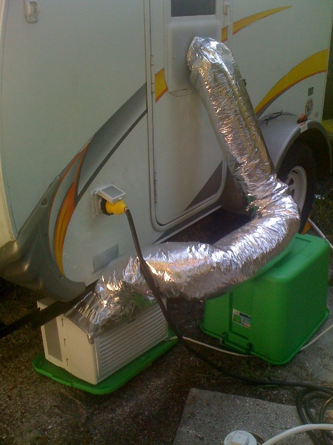

This is what I did, a variation of Shadows install. Image
I purchased a cutting board at a local Walmart, and drilled a 4 inch hole for the hose,. Then installed a 4 inch coupler and drilled two holes on the side and inserted two long screws with washers to secure the board to the trailer. WHat I like is that is not a permanent installation and no holes were drilled.
