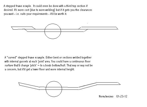

Hi Rob,

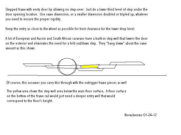

I agree with Andrew on the center and end clearance. A lot of vehicles
have undercarriage items that hang lower than the overall general
clearance. Some mini-van's rear axles seem to be @ 5in or so. I should
think 6-8in in the center and 10-12 at the ends should work - you could
even angle-up the rear somewhat too if you wanted.
Of course it's be more expensive than a straight tube or C-channel, but it
it suits the purpose it may be worth it.
Here's my first attempt at Paint with a couple possibilities I've always
thought might work:
Cheers,
Norm/mezmo

Postby 48Rob » Tue Jan 24, 2012 9:34 am
Hi Norm,
Thank you for the ideas!
The first drawing of the "Z'd" frame is of interest.
It is also what I was thinking about doing, though on a smaller scale.
I would want the main frame "lowered" in the area of the doorway, so you don't have to step up, then back down.
I hadn't considered dropping such a large section, it is an interesting idea that has a lot of merit! :thumbsup:
(good job on the drawing!)

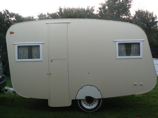

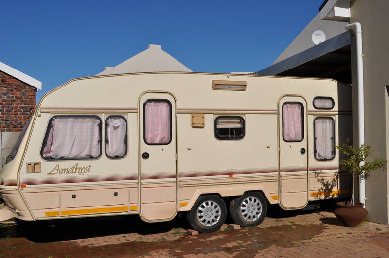

Here's a 1992 Wilk Amethsyt C'van from South Africa showing the entry
step well projecting lower than the C'van's body/frame:
Here's a Vintage [1950-51 Bondwood Type- make unknown] C'van from
the Aussie Vintage Caravans web site[
http://vintagecaravans.proboards.com/in ... hread=9484
] that has one of the lowest entry step wells that I've ever run across:

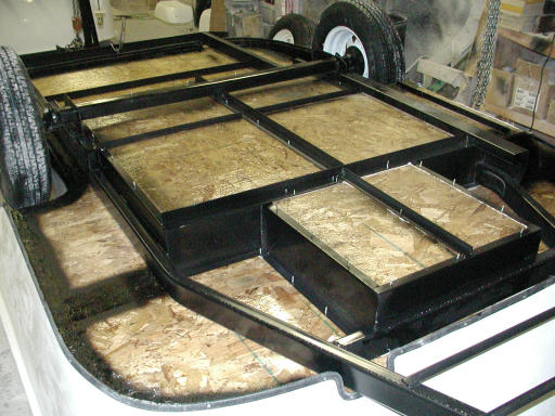

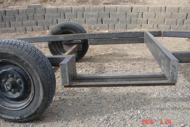

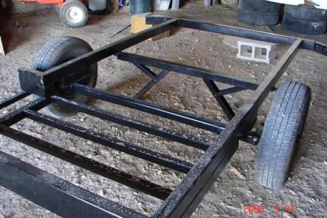

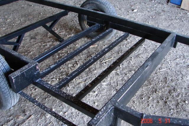

Postby angib » Sun Jan 29, 2012 10:24 am
One corner that can be cut is to reduce the size of the chassis member that goes under the dropped floor entry. These photos show a chassis a guy built to replace the rusty one on his Boler fibreglass trailer and he said it is a replica of the original. Although a 3x2 main rail is used, only a 2x2 is put under the doorway to give maximum ground clearance - those sizes might be 3x1.5 and 1.5x1.5 as I know Scamp uses 3x1.5 for its main rails.
Other fibreglass trailers used a similar chassis design and went even lighter for the member under the doorway. The last photo shows a current-day Scamp chassis and you'll see that they've not only used a smaller tube but they've laid it on its side in its weaker orientation. I think this confirms that the chassis load at this point is nowhere as big as it is further forwards. Some FG trailers do have a reputation for cracking chassis rails but it was always in front of the dropped footwell, where the rails bent inwards to make the A-frame.

Postby 48Rob » Sun Jan 29, 2012 10:33 am
Andrew,
Those are nice pictures, thank you!
I've had that though, but don't have the background to determine without a doubt the exact size I'd need to not stress the frame in that area.
Another thought I've had is to use a piece of plate as the floor and to tie the frame togeter on the bottom, and run an arched doorway, or "frame" from the top of the main frame, up, over, and back down to replace the lost strength?

Postby doug hodder » Sun Jan 29, 2012 10:44 am
Don't know if it would be of help Rob...but here's what Andrew and I cooked up on my standy with the dropped floor. Outer perimeter is all 2x2, angle cross members. Not real visible, but there is a 2x2 tube gusset on the rear of the door opening as well. Doug
