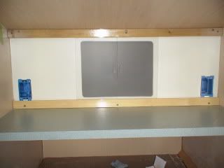

I used a premade from Home depot in my little guy. It's supported on back and front. Thats it. It's bounced around for 12000+ miles with no problems.

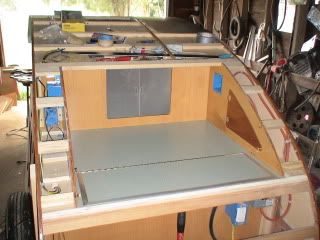

I used cheap Menards laminate, all of the premade stuff I have seen is on heavy wood(that stuff made out of saw dust and glue), I have 1/2 plywood then added 3/4 plywood because the 1/2 seemed flimsy as a shelf, and even with over an inch of plywood I think it is still lighter than premade counter top would be.
After the first attempt I decided the put the laminate under the sidewalls, rather than just butt the laminate up to the sidewalls, and luckily it didn't stick well and peeled up somewhat easily. I haven't tried to peel up attempt 2. I used conact adhesive.
