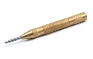

An automatic center punch with the point ground down will leave a dimple without piercing the skin. Until you look at it up close, it passes for rivets. When you're passing it on the road or it's a couple stalls away, you'd never know.
