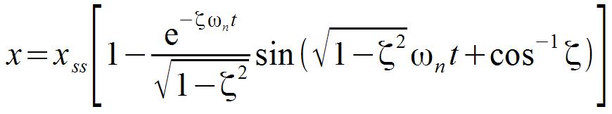

mikeschn wrote:I believe axle location is important. Problem is, there isn't any way to calculate the sway factor.
There are equations, but it takes much more than college algebra to put them to use. In fact, 18 years out of college I would have to do some serious reviewing to do it myself. For example:
This is the equation for a simple damped oscillation ... there are additional equations to find damping ratios, oscillation frequency, rotational inertia in each axis and so on. Not something that is intuitive or usable for the typical builder. AND if you change something, you have to start all over again. In practical use, moving as much mass as you can to just ahead of the axle (reduces yaw inertia), making sure your balance is correct, and using an appropriate drop/lift hitch to make the trailer level would be the easiest things to try. Next would be load equalizing hitch and an anti sway system.
This is one reason why trailers seem to pick up that tandem axle at just over 3500#. It's not about capacity as much as stability. The tandem configuration damps out the yaw movements very quickly and effectively.
Corwin
