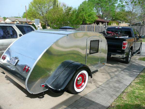

My sidewalls are approximately 1-1/4" thick. (They're insulated.) I used two parallel runs of Grant's hatch seals on the underside of hatch overhang. There is a gap between the seals. My thought was that if water ever got past the outer seal, it would run down the gap between the two seals. As it turned out, the inner seal isn't needed. My hatch doesn't leak even when I pressure wash my teardrop at the neighborhood coin-operated car wash.

Javanino wrote:Too me the hurricane hinge hangover idea ruins the flow and aesthetics of an otherwise really cool design. If it's cut flush and the sidewalls have a notch cut into, it would remedy this. Maybe :)
I generally agree, but using the 10-foot rule, you don't notice the overhang.
What looks like the shadow of the hinge overhang in the picture above is actually a rain diverter made out of 3/4" angle aluminum. (My hurricane hatch extends 3/4" out on each side.)
BTW, referring to the prior post, you can see the double seals that I applied on the underside of my hatch.
That's a beautiful TD you got there. Very impressed. Next time I'm up in the metroplex, would love to check it out.
