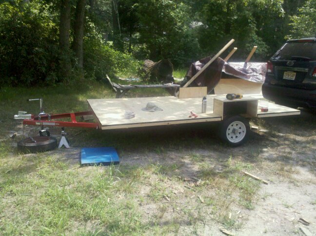

I burned out my fiirst set of tires with about 2500 miles on them this last weekend. I blew one out and had to replacement it...was able to drive home on the other one but it need s a replacement. I was running 12x4.8 weight range c. I need to see if I can squeeze 13's in there if not the 12x5.3's just for a wide higher weight tire. Guy at work said I shouldn't have been driving like 70mph plus when its 100'outside...speed and road temp. Could that be why I wore through them? Sadly I need to upgrade to 5 bolt hubs too...sigh
Deryk the Pirate
Posts: 809
Images: 158
Location: Parlin NJ
Re: 8" WHEELS & TIRES WHO RUNS THEM? FAIL OVER 55MPH?
Postby Deryk the Pirate » Tue Jul 03, 2012 5:19 pm
Well after measureing I have 2.5" on either side of the tire well at whats almost the top of the 12" rim
I can totally do a 13" tire, possibly a 14"
