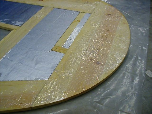

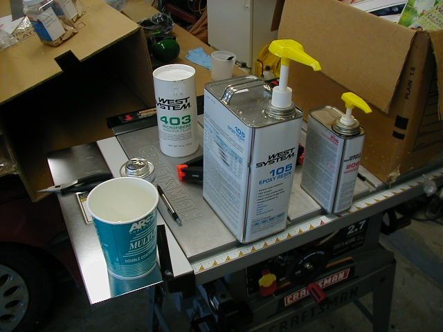

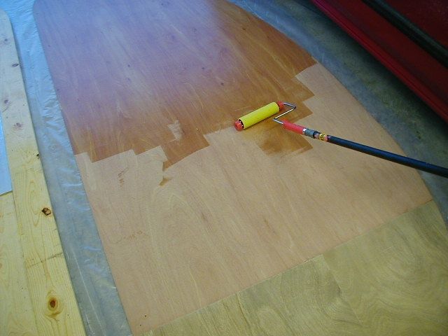

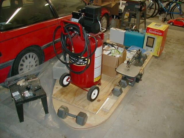

The white foam with silver on the faces is what I used on the top, because it was a lot more "bendy". The foam I used on the sides was rigid, the foam itself was a yellowish color and had kraft paper on the sides one side being silver. It did peel off easily, so when I glued the luan (used epoxy with fibers mixed in), I rolled out the adhesive on the entire surface, but concentrated on the wood parts.
Layed it on the floor with plastic underneath:
Mixed up the epoxy with microfibers:
Rolled it out on both sides:
Concentrated on the wood parts:
Put "gravity clamps" all over until it cured:

Postby Oldragbaggers » Fri Jul 06, 2012 9:47 pm
Love them "gravity clamps"
